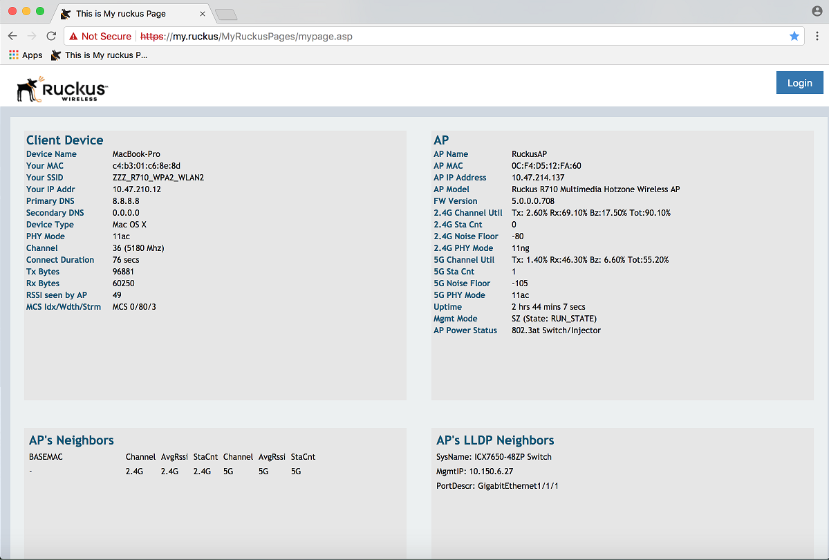

When connected to an authenticated WLAN, you can enter https://my.ruckus on a web browser and view the following diagnostic information:
  • Client Device
  • AP
  • AP's Neighbors (Wireless)
  • AP's LLDP Neighbors (Wired)
Figure 174  Viewing Diagnostic Information in WPA2 WLAN

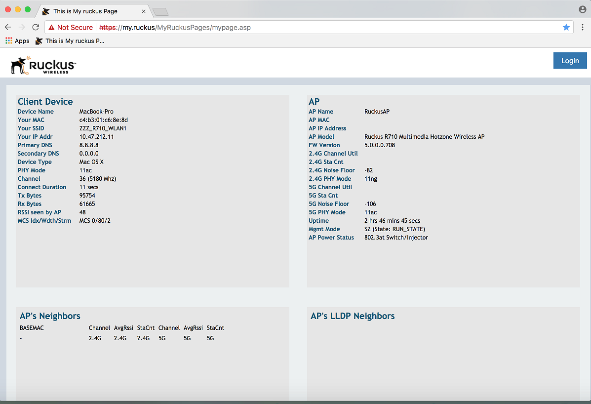

On entering https://my.ruckus when connected over an Open or WEP WLAN, the diagnostic information is restricted for security reasons.
Figure 175  Viewing Diagnostic Information in Open WLAN
