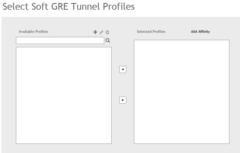

Click the
Select checkbox above the SoftGRE Profiles box.
A form appears from which you can select the SoftGRE profiles that you want to apply to the zone. The profiles you can select are displayed under Available Profiles. Select the profile and click the -> icon to choose it. The profile is now listed under the Selected Profiles area.
Figure 41 SoftGRE Profiles Form
You can also click the + icon to create a new SoftGRE profile.
If you wish to deselect a profile, select it and click the <- icon. The profile will be moved back to the Available Profiles area and will not be applied to that zone.
