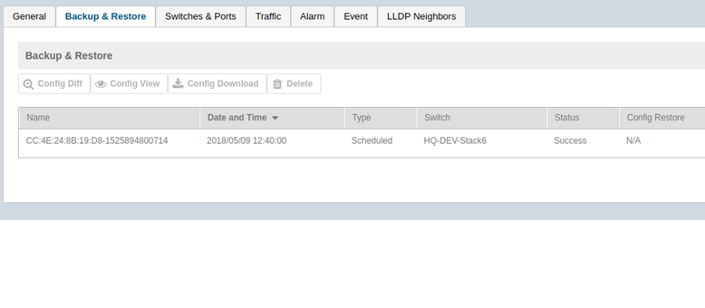

  2. Select the switch and then the Backup & Restore tab.
    Figure 51  ICX Switch Backup & Restore Tab
    The following information about the selected configuration file is displayed in the Backup & Restore tab:
    • Name: displays the name of the configuration file
    • Date and Time: displays the time when the file was created
    • Type: displays whether the configuration was created scheduled or on demand
    • Switch: displays the model number of the switch
    • Status: displays whether the configuration was successful or failed
    • Config Restore: displays whether the configuration fo the selected switch was restored
    To view the difference between two configuration files, select the fields and click Config Diff. A Switch Config Diff page appears displaying the difference between both files.
    To delete a configuration file, select it and click Delete.
