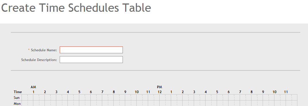

    The Create Time Schedule Table page appears.
    Figure 109  Creating a Time Schedule Table
  4. Configure the following:
    1. Schedule Name: Type a name for the schedule you want to create.
    2. Schedule Description: Type a short description for this schedule.
    3. Draw the schedule table.
    4. Click OK.
You have created the schedule.
