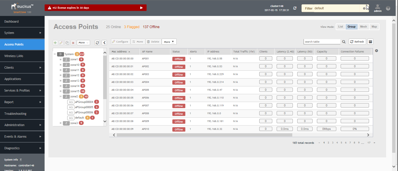

  1. From the left pane, select Access Points. The below figure appears.
    Figure 36  Access Point
  2. From the System tree hierarchy, select the location (for example: System, Domain, Zone) and click . The following figure appears.
    Figure 37  Create Groups
