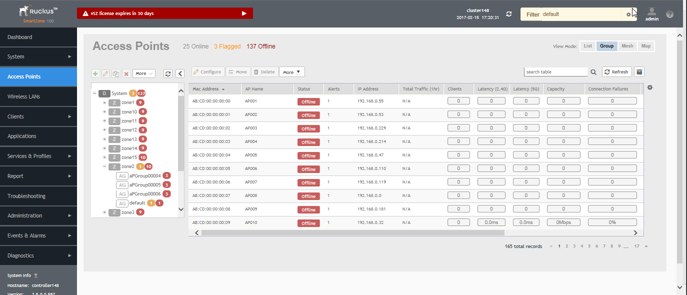

  1. On the menu, click Access Points. The figure below appears.
    Figure 34  Access Points
  2. From the System tree, select the location where you want to create the zone (for example, System or Domain), and then click .
    Figure 35  Create Groups
  3. Configure the zone by completing the settings listed in the table below.
  4. Click OK.
