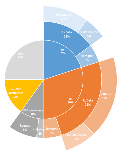

Clicking
Airtime Detail displays a pie chart that depicts a detailed breakup of the reception and transmission percentages (Rx and Tx) against parameters such as Data, Management, Unicast, Multicast, Interference and Network Load. Following are the statistics that are evaluated:
Table 4 Airtime Utilization Statistics Total Total Airtime under observation RxLoad Airtime spent in receiving frames destined to AP in Micro seconds RxInt Airtime spent in receiving frames NOT destined to AP in Micro seconds TxSuccess Airtime spent in transmitting frames successfully in Micro seconds TxFailed Airtime spent in transmit failed in Micro seconds NonWifi Airtime where CCA is busy in Micro seconds RxTotal Same as RxLoad or sum of Rx (Mgmt Unicast + Mgmt Bcast + Data Unicast + Data Bcast) RxMgmtU Airtime spent in receiving Management Unicast frames in Micro seconds RxMgmtB Airtime spent in receiving Management Broadcast frames in Micro seconds RxDataU Airtime spent in receiving Data Unicast frames in Micro seconds RxDataB Airtime spent in receiving Data Broadcast frames in Micro seconds TxTotal Same as TxSuccess or sum of Tx (Mgmt Unicast + Mgmt Bcast + Data Unicast + Data Bcast) TxMgmtU Airtime spent in transmitting Management Unicast frames in Micro seconds TxMgmtB Airtime spent in transmitting Management Broadcast frames in Micro seconds Figure 15 Sample Airtime Utilization Pie Chart
