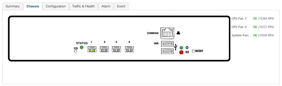

The chassis view provides a graphical representation of the control panel (on the front panel of the controller), including the LEDs.
Use the LEDs to check the status of the ports and power supplies on the controller. Fan status is also displayed on the chassis view.

Chassis tab. The below appears.
Figure 22 Cluster Node Chassis
port 1 and 2 are management ports
ports (3-4 or 3-6) are data ports
