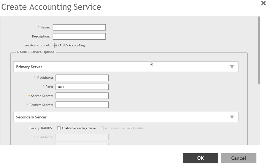

    The Create Accounting Service page appears.
    Figure 99  Creating an Accounting Service
  4. Configure the following:
    1. Name: Type a name for the authentication service that you are adding.
    2. Description: Type a description for the authentication service.
    3. Service Protocol: By default, the RADIUS Accounting selected. For more information, see RADIUS Service Options.
  5. Click OK.
You have completed creating a Proxy Accounting AAA server.
