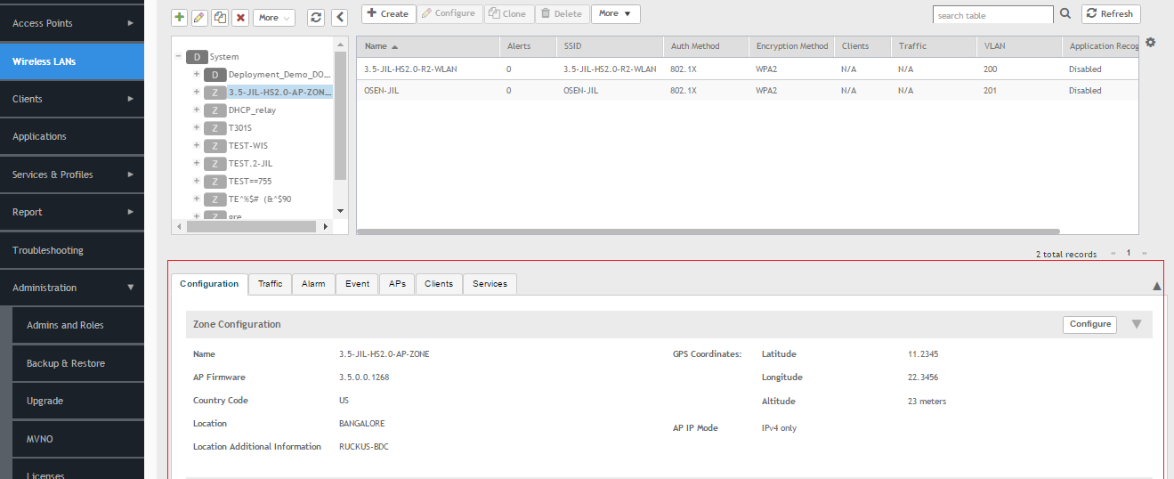

    The zone configuration information is displayed.
    Figure 153  Monitoring Zone Configuration
