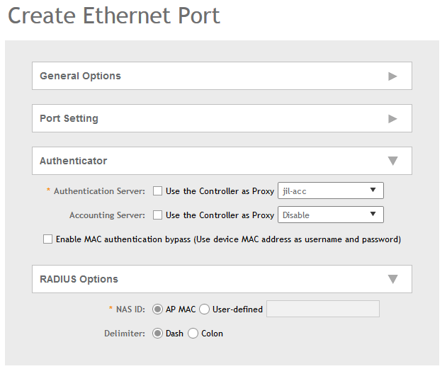

    Figure 107  Creating a Ethernet Port Profile

    5. Authentication and Accounting Services
      1. Authentication Server: Select the check-box and a controller from the drop-down menu to use the controller as a proxy authentication server.
      2. Accounting Server: Select the check-box and a controller from the drop-down menu to use the controller as a proxy accounting server.
      3. Enable MAC authentication bypass: Select this check-box if you want to use the device MAC address as access credentials (username and password).
    6. RADIUS Options
      1. NAS ID: Set the NAS ID for the AP to communicate with the RADIUS server. Options include using the AP MAC address or any User-defined address.
      2. Delimiter: If AP MAC is selected to configure the NAS ID, then you can choose between Dash or Colon as delimiters to separate.
