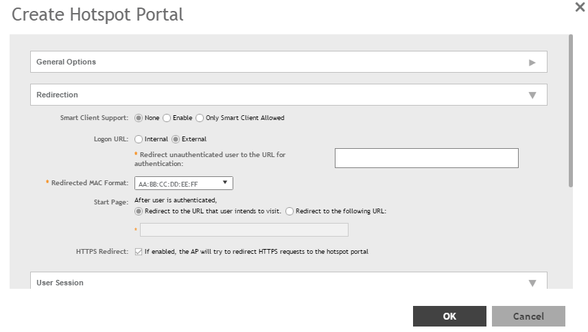

    Figure 65  Creating a Hotspot (WISPr) Portal
  4. Configure the following:
    1. General Options
      • Portal Name: Type a name for the hotspot service portal that you are creating.
      • Portal Description: Type a short description of the hotspot service portal.
    2. Redirection: select where to redirect the user after successfully completing authentication.
      • Smart Client Support: select one of the following
        • None: Select this option to disable Smart Client support on the hotspot service.
        • Enable: Selection this option to enable Smart Client support.
        • Only Smart Client Allowed: Select this option to allow only Smart Clients to connect to the hotspot service.
      • Logon URL: select one of the following
        • Internal: Type the internal URL of the subscriber portal (the page where hotspot users can log in to access the service).
        • External: Type the external URL of the subscriber portal.
      • Redirect MAC Format: Type the MAC address to which redirection must be done.
      • Start Page: select one of the following
        • Redirect to the URL that the user intends to visit: You could redirect users to the page that they want to visit.
        • Redirect to the following URL: You could set a different page where users will be redirected (for example, your company website).
      • HTTPS Redirect: Enable this option if you want the AP to redirect HTTPS requests to the Hotspot portal.
