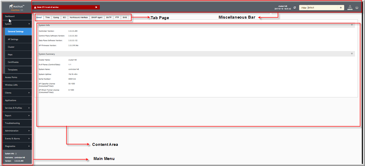

Figure 1
Controller Web Interface Features
The following table describes the web interface features.
| Feature | Description | Action |
| Main Menu | Lists the menus for administrative task. | Select the required menu and sub-menu. |
| Tab Page | Displays the options specific to the selected menu. | Select the required tab page. |
| Content Area | Displays tables, forms, and information specific to the selected menu and tab page. | View the tables, forms and information specific to the selected menu, sub-menu and tab page. Double-click an object or profile in a table, for example: a WLAN, to edit the settings. |
| Header Bar | Displays information specific to the web interface. | Select the required option (from left to right):
You can also use the
icon to expand and shrink the main menu. Shrinking the main menu increases the size of the content area for better readability and viewing.
