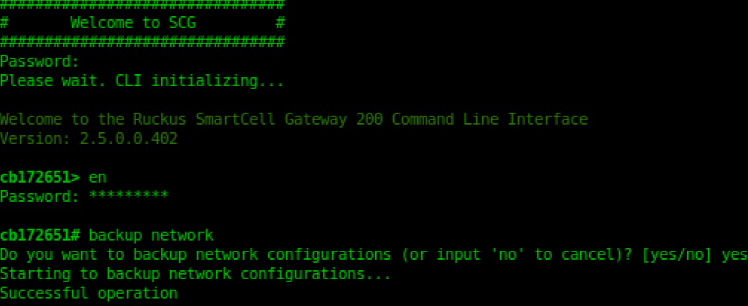

  1. Log on to the controller from the controller's command line interface (CLI). For more information, see the corresponding Command Line Interface Reference Guide for your controller platform.
  2. At the prompt, enter en to enable privileged mode.
    Figure 129  Enable privileged mode

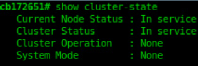

  3. Enter - to display the statuses of the node and the cluster.
    Before continuing to the next step, verify that both the node and the cluster are in service.
    Figure 130  Verify that both the node and the cluster are in service
  4. Enter backup network to back up the controller network configuration, including the control plane and data plane information.
    The controller creates a backup of its network configuration on its database.
    Figure 131  Run backup network

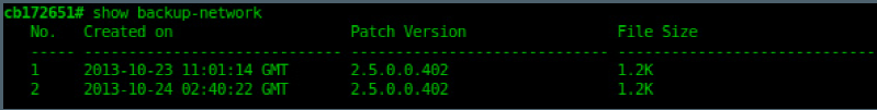

  5. Enter show backup-network to view a list of backup files that have been created.
    Verify that the Created On column displays an entry that has a time stamp that is approximate to the time you started the backup.
    Figure 132  Enter the show backup-network command

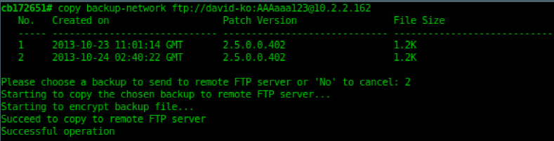

  6. Enter copy backup-network {ftp-url}, where {ftp-url} (remove the braces) is the URL or IP address of the FTP server to which you want to back up the cluster configuration.
    The CLI prompts you to choose the number that corresponds to the backup file that you want to export to the FTP server.
  7. Enter the number of the backup file that you want to export to the FTP server.
    The controller encrypts the backup file, and then exports it to the FTP server. When the export process is complete, the following message appears on the CLI:
    Succeed to copy to remote FTP server
    Successful operation
    Figure 133  Succeed to copy to remote FTP server indicates that you have exported the backup file to the FTP server successfully
