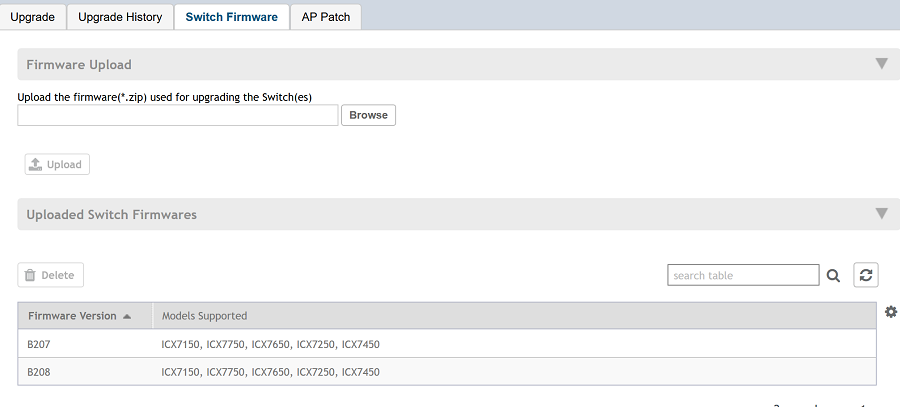

  1. Select Administration > Upgrade.
  2. Select the Switch Firmware tab.
    Figure 141  Upgrading the Switch Firmware
  3. In Firmware Upload click Browse to select the firmware file for upgrading the switch.
  4. Click Open.
  5. Click Upload. The upload status bar is displayed, and after the firmware file is uploaded, the Uploaded Switch Firmwares section is populated with the firmware version and switch models it supports.
You have successfully uploaded the switch firmware to the controller.
