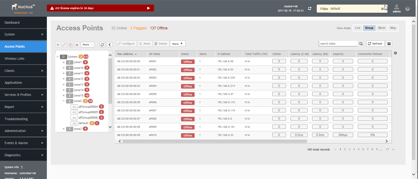

  1. On the menu, click Access Points. The figure below appears.
    Figure 32  Access Points
  2. From the System tree, select the location where you want to create the zone (for example, System or Domain), and then click .
