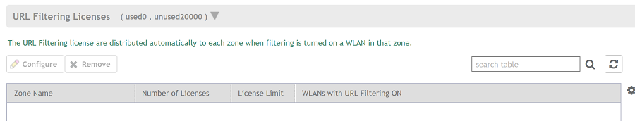

    The URL Filtering Licenses page displays the following:
    Figure 143  URL Filtering Licenses
    • Zone Name: name of the zone within which APs are present
    • Number of Licenses: displays the total licenses allocated to the zone
    • License Limit: can be set to a value or can be Unlimited. This displays the number of APs (with URL filtering enabled) that can be accommodated within the zone.
    • WLANs with URL Filtering ON: displays all the WLANs within the zone that have the URL filtering service enabled
  3. Select the URL license and click Configure.
    The URL Filtering Licenses page appears.
  4. Configure the License Limit as appropriate for the zone.
  5. Click OK.
